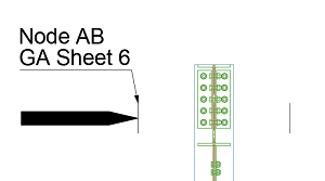

| Limited depth and unlimited xy viewport |
The view of the drawing is along the camera view direction, the symbol displayed on the drawing will be a small rectangle, with a fixed size (in this case, the rectangle would have to display the xy viewport, which is set to unlimited): ![]() When the view is perpendicular on the camera view direction, the fixed depth is visible in the view, the camera symbol will be represented by two parallel lines, marking up the two boundary plans: ![]() |
| Limited depth and xOy viewport | In this case, the symbol will appear as a rectangle or as a circle, highlighting the size of the box regardless of view direction. |
