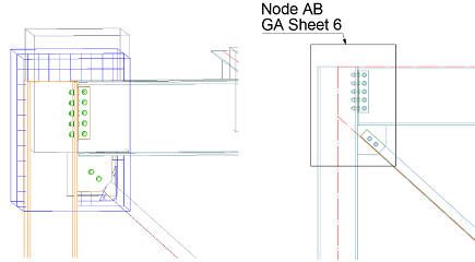

Cameras created in the model can be detailed on general arrangement drawings using a symbol representation and a label showing information about the camera.
This detailing functionality helps with referring camera drawings of specific parts of the model in general arrangement drawings, such as plan views or elevations.
Besides camera objects, you can also detail the camera symbol for model views that have the Create automatic drawing option checked.
