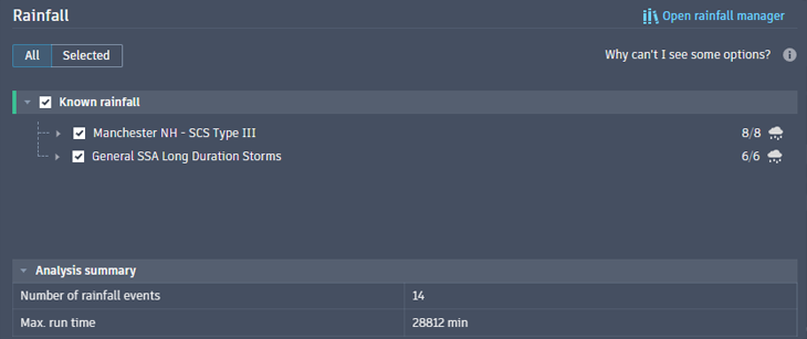

Select which rainfall data sets to use for analysis.
Under the Rainfall section, select one or more Rainfall Sets to apply to the drainage system.
The counts to the right of the Rainfall Sets represent the total number of events selected out of the possible number of events in the set. The Analysis Summary at the bottom displays the total number of Rainfall events applied to the drainage system and the largest specified maximum run time of the events.

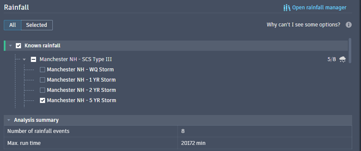

To Select Specific Events in a Rainfall Set
Select fewer or specific events in a Rainfall Set.
  1. In the Rainfall List, expand the Rainfall Set containing the desired Rainfall Events.
  2. Select/deselect events to refine for analysis.
    Note: You can deselect a whole set if needed.
    Notice the selected counts have changed, as has the Analysis Summary.
