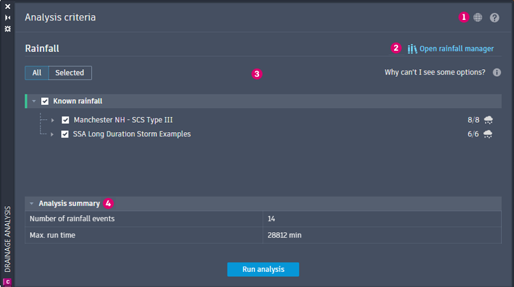

The Analysis Criteria User Interface
The beginning Analysis Criteria user interface allows for specifying rainfall data to test the current drainage system. If Rainfall Sets have not been configured for the project, you will only be able to open the Rainfall Manager from the interface. Rainfall data is required to begin the analysis process.
  1. Server Region Settings. Specifies a geographically specific server for cloud processing. Learn more.
  2. Rainfall Manager. Opens the rainfall manager to edit and select individual rainfall events. Learn more.
  3. Project Rainfall Sets. A list of currently configured rainfall sets to apply and test the drainage system. Learn more.
  4. Analysis Summary. Displays the total number of Rainfall events applied to the drainage system and the largest specified maximum run time of the events.
