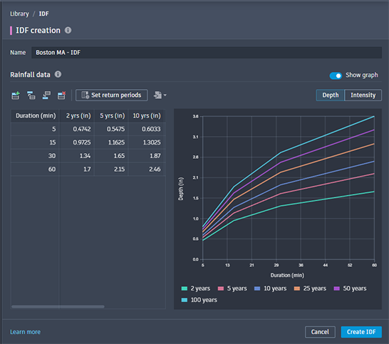

  2. In the Rainfall Manager, click the IDF tile. The IDF Creation editor opens.
  3. In the Name field, enter a unique name for the rainfall set.
Note: At least one rainfall duration must be entered before the rainfall set can be saved.

Multiple IDF rainfall curves can be created for different return periods by specifying rainfall intensity (or depth) values for different rainfall durations.
  1. Click to import IDF data files. The supported files are as follows:
    • Custom file (.csv)
    • NOAA file (.csv)
    • Hydraflow IDF file (.idf)
    • SSA IDF file (.idfdb)
  2. The data is then presented in a table and an IDF curve graph.
    Note: Use the Show Graph button to hide and show the curve graph.
    The table and IDF curve graph can display either Depth or Intensity data. Data displays using the units defined in the source drawing.
    Note: There must be at least two entries containing the minute increment and its coinciding rain depth in inches (or millimetres depending on drawing units).
  3. Click Create IDF to add IDF rain data set to the Rainfall List.
