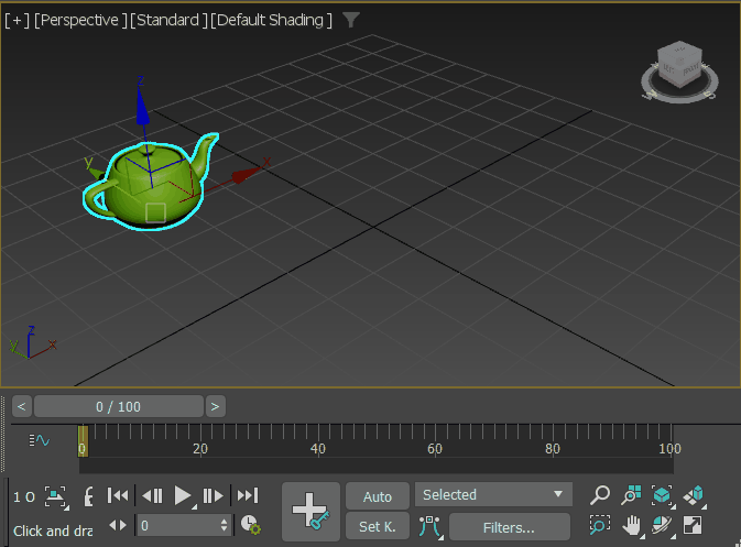

To create animation, turn on the Auto Key button, move the time slider to a particular frame, and then change something in your scene. You can animate the position, rotation, and scale of an object, and almost all other settings and parameters.
Using Auto Key to create animation
When you make a change, 3ds Max creates a key storing the new value for the changed parameter at the current time. If that key is the first animation key created for the parameter, a second animation key is also created at the Auto Key default frame to hold the parameter’s original value.
Keys are not created at the default frame until you create at least one key at a subsequent frame. After that, you can move, delete, and re-create keys at the default frame.
Turning on Auto Key has the following effects:
To begin animating an object:
Click Auto to turn on Auto Key mode.
Drag the time slider to a different time.
Do one of the following:
For example, if you have a cylinder that has not been animated yet, it has no keys. If you turn on Auto Key, and at frame 20 you rotate the cylinder 90 degrees about its Y axis, rotation keys are created at frames 0 and 20. The key at frame 0 stores the original orientation of the cylinder, while the key at frame 20 stores the animated orientation of 90 degrees. When you play the animation, the cylinder rotates 90 degrees about its Y axis over 21 frames.
