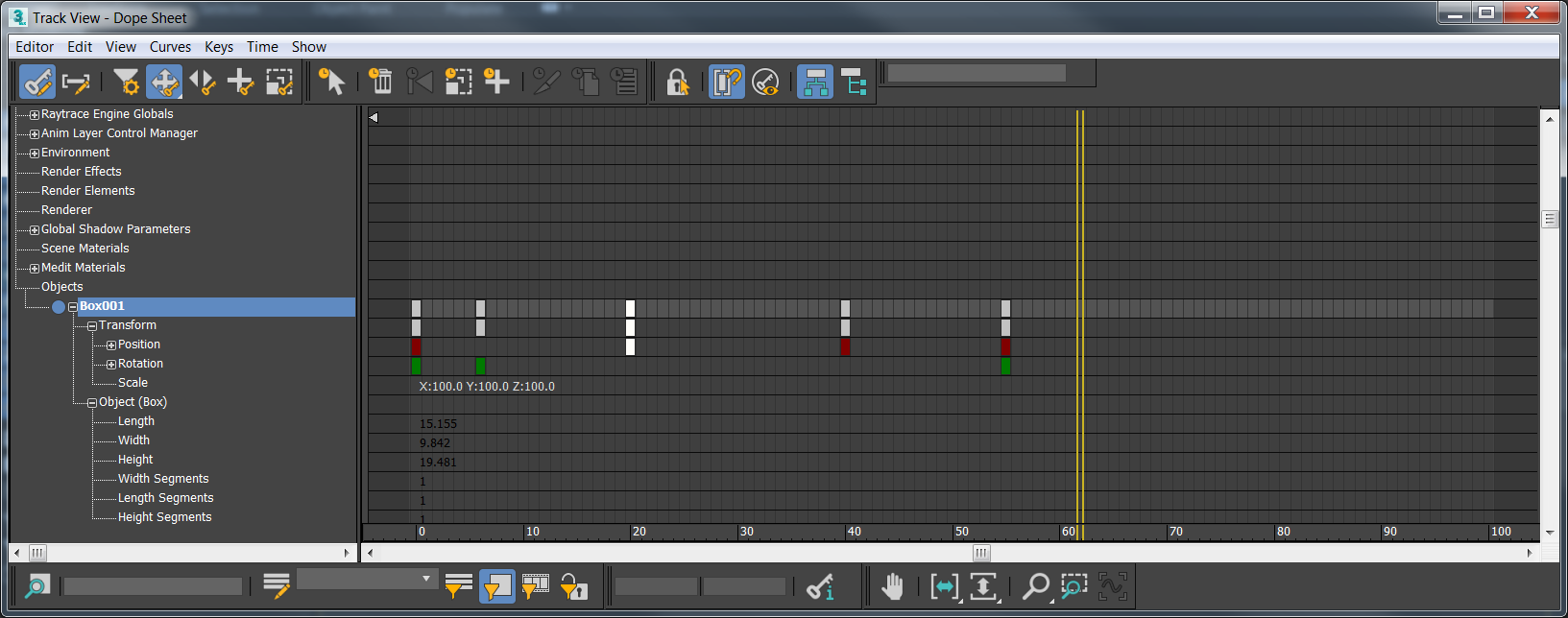

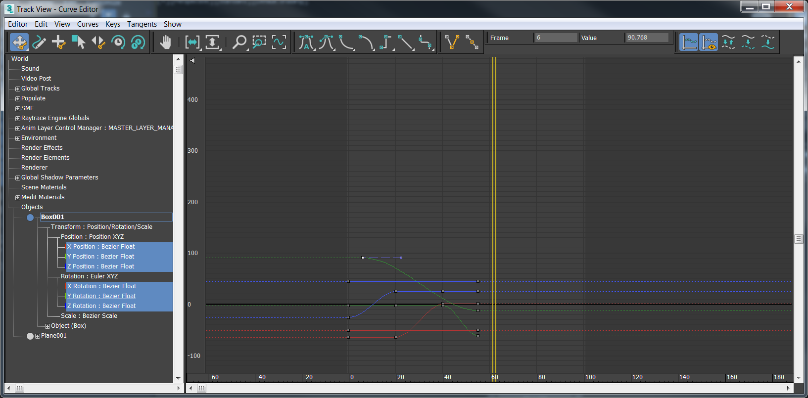

Track View uses two different modes: Curve Editor and Dope Sheet. Curve Editor mode displays animation as function curves, while Dope Sheet animation appears as a spreadsheet of keys and ranges. Keys are color-coded for easy identification. Some Track View functions, such as moving and deleting keys, are also available on the track bar near the time slider, which can be expanded to show curves as well. The Curve Editor and Dope Sheet open by default as floating windows, but you can also dock them under the viewports at the bottom of the interface, or even open them in a viewport. You can name Track View layouts and store them in a buffer for later reuse. Track View layouts are stored with the MAX scene file.

Track View - Curve Editor
Track View - Dope Sheet (Edit Keys)

Select the object, and then right-click it and choose Curve Editor from the menu.
Expand the object hierarchy to find the track or tracks to adjust.
From the Editor menu, choose Dope Sheet.
On the Dope Sheet, click Edit Ranges.
Adjust the range duration by dragging its endpoints, or its position in the animation by dragging between endpoints.
