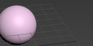

Example: To use the Position XYZ and Noise controller together:
  1. Create a sphere.
  2. On the image Motion panel > Parameters > Assign Controller rollout, click the Position track of the sphere.
  3. Click image (Assign Controller) and choose Position XYZ.
  4. Turn on image and create three keys that image move the sphere on the XY plane.
  5. On the Assign Controller rollout, expand the Position track and click Z Position.
  6. Click image (Assign Controller), and then double-click Noise Float to assign it.
  7. image Play the animation. The sphere moves around the keys that were created earlier. The random vertical movement is generated by the Noise controller on the Z track.
