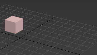

Example: To use the List controller to combine two controllers:
  1. Create a box, and then turn on image. (See Auto Key Animation Mode.)
  2. Create a simple animation containing three position keys.
  3. On the image Motion panel > Parameters > Assign Controller rollout, click the position track to highlight it.
  4. Click image (Assign Controller).
  5. Click Position List on the Assign Position Controller dialog. Click OK.
  6. Click the plus sign in the Position track to expand the track.
    A Position XYZ track and a track labeled Available are now visible.
  7. Click the track named Available and then click the Assign Controller image button.
  8. Choose Noise Position in the Assign Controller dialog, and then click OK.
    The Noise Controller dialog opens.
  9. Play image the animation.
    The box follows the original animated path while vibrating randomly.
    Experiment with different Weight settings for each controller and see the results.

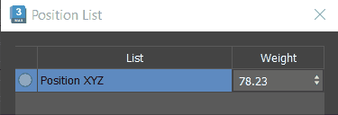

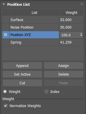

Motion panel > Parameters > Position List rollout
List Window
Displays all the controllers in a list, with evaluation order from top to bottom. The controller at the top of the list is evaluated first; lower controllers are layered onto the result of higher controllers.
Append
Adds a new default controller to the end of the list. (You can set a new default controller by selecting a controller in the Assign Controller list and clicking the Make Default button.)
Assign
Replaces the selected controller with a new controller.
Clicking Assign opens the Assign Controller list. Double-click a controller to replace the selected Position List controller with it.
Note: The replacement controller still uses the original controller's Weigh values.
Set Active
Determines which controller is affected by interactive changes in the viewport. The current active controller is marked with an arrow in the list.
For example, you have an object using a Position List, with Noise Position and Bezier Position in the list. The Bezier Position controller handles the general motion path of the object, while the Noise Position controller adds a random shake to the motion.
Delete
Deletes the selected controller.
Cut
Removes the selected controller and stores it in a temporary clipboard. The clipboard contents are only held within the controller itself until you paste the controller.
Paste
Puts the contents of the clipboard in the position above the selected controller. The clipboard is empty after pasting.
Weight: Normalize Weights
Select the Weight option to activate the Weight setting:
When on, the weight values of all the controllers in the list are averaged. Available only for the Transform List, Position List, and Scale List controllers. Default=off.
Index
Select the Index option to activate the Index settings:
Setting Function
Index Choose which sub controller to use.
By Name Choose sub controller index by name search. Matches incomplete names. Double click in table to rename.
Editable Name Field
Select one of the controllers in the list window of the Controller list, and then enter a descriptive name in this field. This field lets you rename the controller so it's easier to identify.

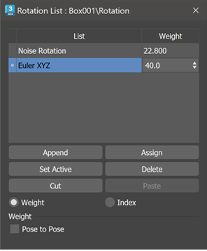

Motion panel > Parameters > Rotation List rollout
Note: The Rotation List rollout interface is the same as the Position List rollout except for the Pose to Pose Weight settings. For all other settings, refer to the Position List rollout examples listed at the start of this topic.
Pose to Pose
Enables blending among controllers in the list. Available only for the Rotation List controller. Default=off.
When off, the List controller weights each rotation individually and adds up the weighted rotations for the final effect. You animate by stacking layers on top of layers, and then weighting in and out their effect. This is the default behavior.
When on, each pose is blended with the results from the previous controllers in the list. This method is not additive, but is instead true pose-to-pose blending. Adjusting the weight of a controller in the list will blend to and from that pose (controller in list). If the last weight is 100.0, then adjusting the weights of the previous poses in the list won't have any effect because the last pose has full effect. This is a stack-based approach that is best used for nonlinear animation (NLA) effects. You can paste motion clips or even single-frame poses onto new layers and use the weights to blend the poses together.

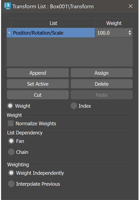

Motion panel > Parameters > Transform List rollout
Note: The Transform List rollout interface is the same as the Position List rollout except for the List Dependency and Weighting Weight settings. For all other settings, refer to the Position List rollout examples listed at the start of this topic.
List Dependency
Use the List Dependency options to treat the list like a fan or a chain: is it order dependent, is an accurate parent transform needed?
Dependency Behavior
Fan Passes the parent transform to list entries then blends together using the weighting method. This setting is useful when entries are independent and order doesn't matter.
Chain Passes the previous result into the next as the parent transform, and then blends using the weighting method. This setting is useful when list is order dependent or when an accurate parent transform is needed, for example, with constraints
Weighting
Choose how to apply weighting:
Weight type Behavior
Weight Independently Weights list entries independently then combine. Rotation component weighting clamped between [-100%,100%]. Note: Avoid non-uniform scaling
Interpolate Previous Interpolates the previous list entry with the current entry. Rotation is pose-to-pose interpolation like rotation_list (clamped [-100%,100%]). Scale weights the multiplied difference from previous. Note: Avoid non-uniform scaling
