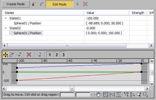

  11. On the Reaction Manager dialog, click image (Create State).
    This creates a new state (State002) using the current positions of the box and sphere.
  12. Try moving the sphere in the Front viewport.
    You can't move the sphere because it's under the full control of its driver, the box. Similarly, you can't change its position using the Coordinate Display fields on the status bar. However, you can change the sphere's position using the Reaction Manager's editing tools.
  13. On the Reaction Manager dialog, click the Sphere001 / Position entry under State002 to highlight it, if necessary, and then click the Edit Mode button.
  14. Position the sphere at (0,0,100).
    The position updates in the Sphere001 / Position line under State002. Also, the Reaction Manager graph shows the change in values of the driven object's(sphere) X and Z position values as the driver box's X position changes. On the graph, as in Track View, red=X, green=Y, and blue=Z.
  15. Click the Edit Mode button again to turn it off, and then scrub the time slider.
    As the box moves between frames 0 and 50, the sphere rises to the position specified in the second state.
