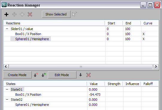

    The sphere's Hemisphere track is added as a reaction driven of the slider, and a new state for the two is added to the States list.
    You now have two states in the States list, but in both cases the state value (that is, the slider value) is the same, so you really need only one. You can resolve this by adding the Hemisphere reaction driven track to the first state and then eliminating the second state.
  12. In the Reactions list, click the Sphere01 / Hemisphere entry, and in the States list, click the State01 entry.
  13. On the center toolbar, above the States list, click image (Append Selected).
    This adds the Hemisphere track to State01.
    Now you can delete the second, superfluous state.
  14. In the States list, click the State02 entry, and then on the toolbar above the States list, click image (Delete State).
    State02 goes away.
    Currently, the box is where you created it, but you might want it to start out at a different location. However, because the box is a reaction driven of the slider, you can't move it freely on the X axis. You'll use the Reaction Manager to set the X position of the box to a specific value.
  15. In the States list, position the click and hold the mouse cursor over the Box01 / X Position > Value entry.
    Note: Your value probably differs from that shown in the illustration.
  16. Drag upward to increase the value, or downward to decrease the value. Change the value to about –50.0.
    You might find it difficult to set an exact value by dragging, which changes only the tenths (and higher) value. You can use the keyboard to specify a more exact value.
  17. Double-click the value.
    The value highlights and becomes a keyboard-editable field.
  18. Enter –50 and press Enter or Tab.
    The value now displays as –50.000.

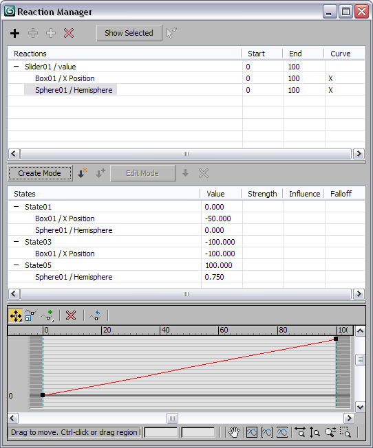

  20. Above the States list, click Create Mode.
    When Create Mode is on, you can change reaction driver and driven properties and use the current properties to create states.
  21. On the main toolbar, click image (Select And Manipulate), and then drag the slider pointer all the way to the left, so the slider value reads –100.0.
  22. In the Reactions (upper) list, click the Box01 / X Position entry to highlight it, and then move the box about –50 units on the X axis, to about X=–100.
    Highlighting the driven entry lets you manipulate the driven value interactively in the viewport while Create Mode is on. Then, when you click Create State, a new state is created for that driven entry only. If you highlight the reaction driver instead, you can manipulate all driven entries freely, but then clicking Create State creates a state for all driven entries. Reaction Manager is a complex tool, so in general it's best to keep the data as simple as possible.
  23. Click image (Create State).
    The Reaction Manager adds a new state, State02, with the state (slider) value at –100.0, and the box at its new X position.
  24. Turn off Create Mode. Move the slider left and right to see how this affects the box position.

  26. Turn on Create Mode, and then and in the Reactions list, click the Sphere01 / Hemisphere entry.
    The Hemisphere parameter is now available.
  27. On the image Modify panel, set Hemisphere to 0.75.
  28. In the Perspective viewport, drag the slider all the way to the right.
  29. Click image (Create State).
    The Reaction Manager adds a state with the state (slider) value at 100.0, and the Sphere01 / Hemisphere value at 0.750.
    Also, if you click Slide01 / Value in the Reactions list, you can see in the graph showing the slider value on the horizontal axis and the two reactions on the vertical axis. The scale between the two is different, so the Hemisphere reaction on the right side of the graph looks like a straight line, but when you click Sphere01 / Hemisphere in the Reactions list, the graph shows a steady rise from 0.0 to 0.75.
  30. Turn off Create Mode. Drag the slider in both directions.
    Over the left half of the slider range, the box moves along the X axis. Over the right half of the range, the sphere's Hemisphere value changes.
    To finish the procedure, you'll experiment with using the graph to change a reaction.
  31. If you haven't already, click the Sphere01 / Hemisphere driven entry in the Reactions list, and then click image (Zoom Extents) below the graph.
  32. Click image (Add Point), and then click the middle of the graph curve (it's the red, diagonal line).
    This adds a new point to the curve and a new state in the States list.
  33. Click image (Move), and then drag the new point upward so it's above the right-hand endpoint.
  34. Drag the slider again.
    As the slider moves from 0 to 100, the Hemisphere value increases so much that the sphere disappears, and then decreases so you can see the upper fourth of the sphere.

Note: If you replace a reaction driver with multiple states, Reaction Manager deletes all existing states except the default one. In essence, replacing a reaction driver is like starting over.
Add Driven
Lets you add a reaction driven item to the current reaction driver. For details, see Add Driven.
Add Selected
Lets you add selected objects as driven entries to the current reaction driver. For details, see Add Selected.
Delete Selected
Deletes any items highlighted in the Reactions list. For details, see Delete Selected.
Create States Mode
Lets you create states on the fly by manipulating objects in the viewports. For details, see Create Mode.
Create State
Adds a state to the States list for the current reaction. For details, see Create State.
Append Selected
Adds a driven item to a state in which the driven item doesn't currently participate. To use, highlight a driven item in the Reactions list, highlight a state in the States list, and then choose Append Selected.
Set State
Updates the highlighted state (reaction driver track) to its current value. For details, see Set State.
Delete State
Deletes any highlighted items in the States list.
Edit Driven State Mode
Lets you change the values in the current driven state. For details, see Edit Mode.
Show in Track View
Opens Track View, displaying reaction tracks for highlighted drivers and driven items only.
Show in Schematic View
Opens Schematic View, with reaction tracks expanded for highlighted drivers and driven items.
