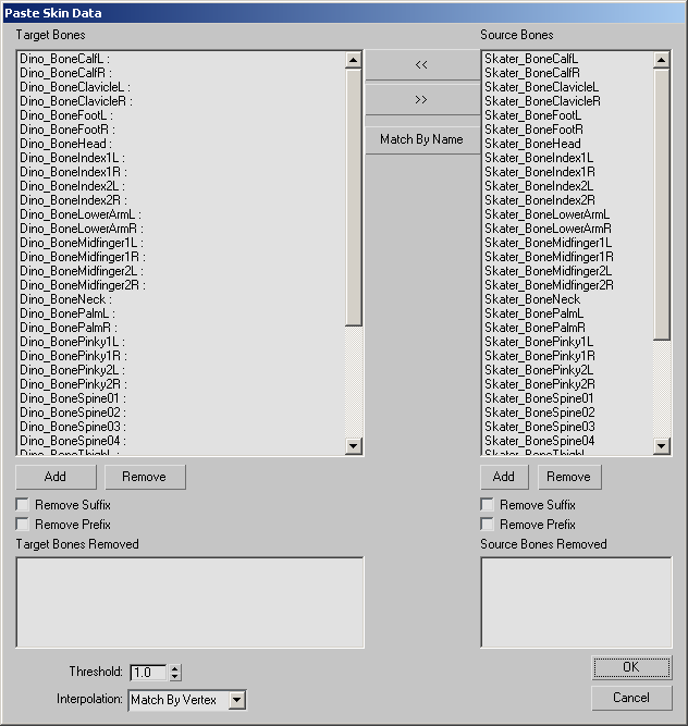

    3ds Max opens the Paste Skin Data dialog.
  9. Match up the bones by highlighting one on each side of the dialog, and clicking the left arrow to move the source bone to its match on the left side.
    You can also highlight several bones on each side at once, and click the left arrow to move them all over at the same time. Only bone pairs on the left side of the dialog will be pasted.
  10. If the meshes' vertices do not match exactly, set the Interpolation method to Match by Face, and increase the Threshold to a unit value that will allow the meshes' faces to match up.
  11. Click OK to paste the vertex weights and close the dialog.
To use the Paste Skin Data dialog, highlight matching Target Bones and Source Bones, and click the left arrow to match them. Only matched sets of bones listed under Target Bones will be mapped when you click OK.
Target Bones
Lists target bones available for matching, and lists matches moved from the Source Bones listing with the left arrow.
Source Bones
Lists source bones available for matching.
Add
Adds removed bones back to the source or target list.
Remove
Removes highlighted bones from the source or target list.
Remove Suffix
If bone names end with an underscore followed by text, this removes the suffix from the displayed bone names from the underscore to the end of the name. Use this option to remove suffixes and make source and target bone names match, which will allow you to use the Match by Name option.
Remove Prefix
If bone names start with text followed by an underscore, this removes all characters from the displayed bone names up to and including the underscore. Use this option to remove prefixes and make source and target bone names match, which will allow you to use the Match by Name option.
image Left Arrow
Matches highlighted target bones to highlighted source bones. The source bone name is moved to the left side of the dialog, where it follows the target bone name. You can also match more than one source bone to a single target bone by highlighting the target bone and the source bones and clicking the left arrow. When you click OK, only the matches listed on the left side of the dialog will be mapped.
image Right Arrow
On a highlighted match on the left side of the dialog, removes the match and moves the source bone to the right side of the dialog.
Match by Name
Matches the source and target bones by name. You can use this option only if you have removed prefixes or suffixes to make the displayed source and target bone names match exactly.
Threshold
Sets the unit distance that the utility will search for vertex or face matches. Default=1.0.
Interpolation
Sets the method by which pasting will take place. Use the Match by Vertex option only if the meshes are identical. Otherwise, use Match by Face. Default=Match by Vertex.
