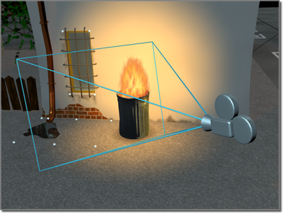

    Real-world camera films a scene (the white dots will be tracking points).

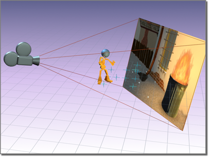

  4. Associate each tracker with its corresponding scene point object.
    The associated scene point objects are set up in 3D space based on real-world dimensions.

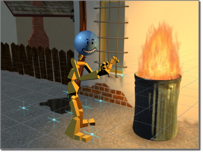

  8. Choose the camera that will be matched in the Match-Move rollout, select which camera parameters you want to estimate, set the movie and scene animation frame ranges and perform the match. This generates a keyframed animation of the selected camera parameters.
    After camera tracking, scene geometry (the character) matches the filmed background.
