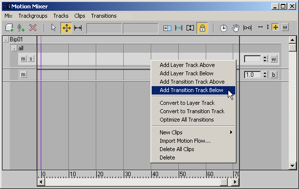

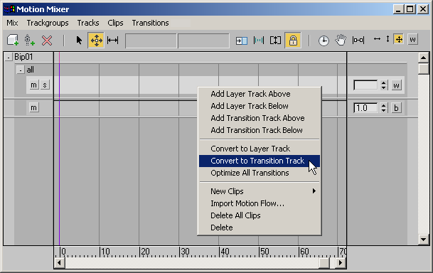

Types of Clip Tracks
There are two types of tracks to which you can add clips:
Layer
A track for a series of motions that do not need transitions between them. By default, a Layer track is created for a biped when you open the Mixer.
Layer track
Transition
A tall track with room for two rows of clips. You can put one motion file on the top tier and another on the bottom, and place a transition in the area where the two clips overlap. Transitions on these tracks are similar to Motion Flow transitions between clips.
Transition track

To add a Transition or Layer track to a trackgroup:
To convert a clip track from one type to another:
