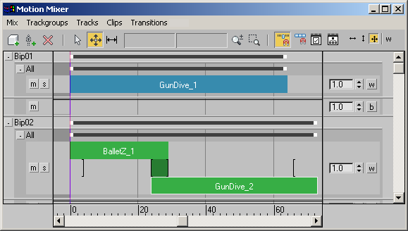

Interpreting Clip Names
When you load a clip into the Mixer, the clip appears on the track as a solid bar, with its name displayed on the clip.
image Other information can appear on the clip, such as the start and end frames, and the clip scale. You can change the information that displays on the clip by clicking Preferences on the Motion Mixer toolbar, and changing the Clips options on the Mixer Preferences dialog.
You can use the same clip numerous times in the Mixer. Each version of the clip displays the name of the BIP file, followed by a number, such as 1 or 2. The name might also have the letter Z between the name and number. These suffixes tell you how the clip is interpreted by the Mixer.
When you load a biped clip from a file, you have the option of setting the lowest starting foot height to Z=0 (the construction plane). If you leave this option turned on, the clip's motion will be moved in space so the biped's feet fall on the construction plane on the first frame of the clip. The letter Z appears after the clip name to indicate this setting.
When you load a clip into the Mixer for the first time, the clip name is followed by the number 1. If you clone or load the same clip to another part of the Mixer, the clip will display the same number or a different number depending on whether the new clip is an instance or an adaptation of the original clip. Instances are versions of the same clip used with the same object, or different objects of the same size. Adaptations are versions of the clip used with objects of different sizes.
The Mixer displays instanced clips with the same numbers, while adaptations receive sequential numbers. For example, if you clone a clip with the number 1 to a track for the same object, the new clip's name is also followed by the number 1. If you clone the clip to a object with a different size, the new clip is an adaptation, and the displayed name is followed an incremental number: in this case, the number 2. If you then clone the adaptation to another track for the same object, the new clip is an instance of that clip, and will be displayed with the number 2. These numbers can help you determine which clips are instances of one another, and which are adaptations.
The ability to tell instances from adaptations becomes important when you replace a clip in the Mixer with another clip. During this operation, you have the option of replacing only the selected clip, only the instances of the clip, or all instances and adaptations of the clip.
