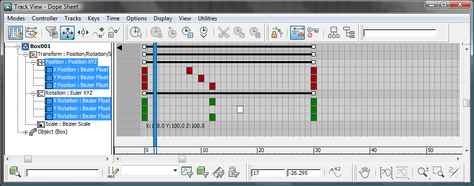

Unlike Curve Editor, Dope Sheet has two modes: Edit Keys and Edit Ranges. These modes affect the display in the Key window.
Edit Keys Mode
When Edit Keys is active, the keyframes are displayed as boxes within rectangles on a grid. The keys are color-coded to show what has been keyframed (position is red, scale is yellow, rotation is green, and so on.)
Colored keys
Dope Sheet keys are now displayed as rectangles within boxes so you can easily spot sub-frame keys, keys that fall in-between frames. Keys that fill the boxes are on the frame, keys that are small rectangles are sub-frame.
