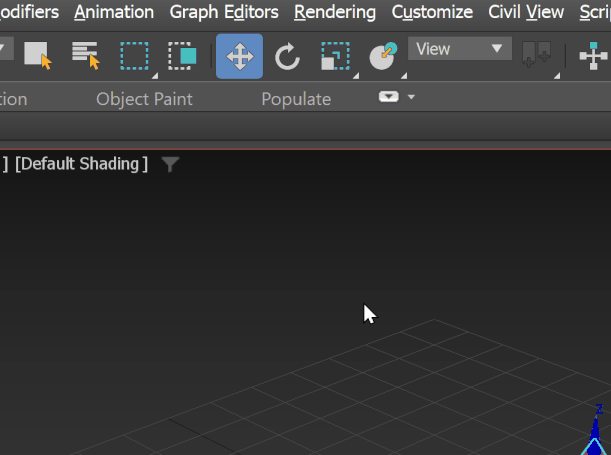

You can assign controllers using the Animation menu. All the controllers and constraints are available by going to the menu bar, choosing Animation, and then selecting a Controller and picking it from the submenu.
Note: Controllers are only available in the full Animation menu. If you do not see Controllers listed in the menu, select Main Toolbar - Default (or Reset to Default State) from the Workspaces drop down menu at the top right of the UI.
When you assign a controller this way, a List controller is automatically assigned, and the controller you assigned appears as the first entry in the list. This automatic List controller assignment does not occur if you assign controllers using the Motion panel or Track View. Weighted list controllers allow you to blend between various tracks by animating the weights.
Tip: You can use the Animation menu to assign the same type of controller or constraint to several different objects at once. Select the objects and then choose the controller or constraint from the Animation menu.
