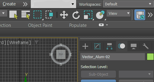

The default position of the Workspaces drop-down list

The Workspace Selector is a two-part drop-down list on the main interface.
The upper part lists the available workspaces. To change the active workspace, simply choose its name from the list.
Note: All included workspaces use the default menu system and horizontal ribbon except for Alt Menu and Toolbar, which docks several toolbars to the left of the viewports, uses the alternate menu system.

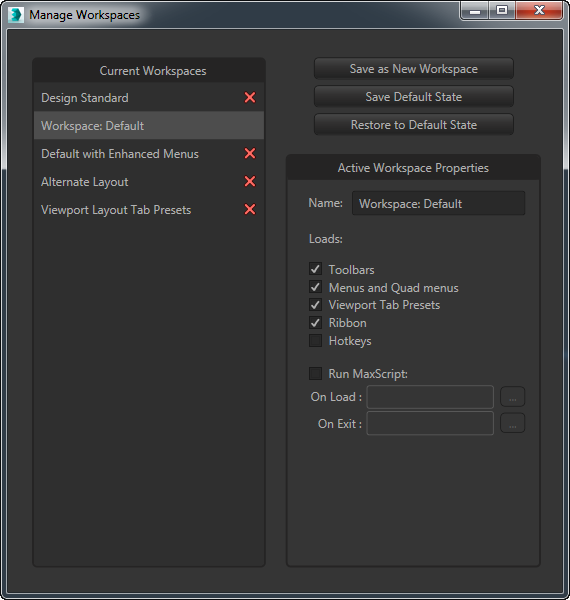

Manage Workspaces dialog
Choosing the Manage Workspaces command opens this dialog, where you can switch, add, edit, and delete workspaces.
Current Workspaces
Lists currently available workspaces. To switch to a different workspace, click its name in the list. This is the same as using the Workspace Selector.
To delete a workspace from the list, click the red X button to the right of its name in the list. You can delete only inactive workspaces other than the default workspace.
Save as New Workspace
Creates a new workspace that is a copy of the active workspace, adding it to the Workspace Selector.

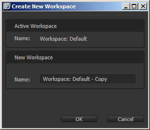

Clicking this button opens the Create New Workspace dialog:
The read-only Active Workspace parameter shows the name of the active workspace: the one being copied. The New Workspace parameter shows the name for the new workspace, which, by default, is the name of the active workspace with " - Copy" appended. To change the name, click in the Name field and enter a new name. To create the new workspace and add its name to the drop-down list, click OK. Or, if you change your mind, click Cancel.
After you create a new workspace, it automatically becomes the active workspace. Any subsequent changes you make to the workspace are saved to that workspace.
Save Default State
Saves the current state of the active workspace as the default state. If you change the workspace subsequently and then use Restore/Reset To Default State, this default state is restored.
If you don't use Save Default State, the default state of the workspace is its state as created.
Restore to Default State
Loads the saved definition of the workspace, based on the active workspace properties (see following). For details, see Workspace States and Default States, preceding.
Active workspace properties
Use these switches to specify the categories of properties that are loaded from the saved workspace definition when you access the workspace. For any inactive property categories, the switched-to workspace inherits the active settings from the previous workspace.
Name
Displays and lets you edit the name of the workspace.
Toolbars
Loads properties for all items on the Customize Display Right-Click menu, including which items are open, their positions, and any customization applied to the toolbars.
Loads menu and quad menu contents from the workspace definition. This includes the active menu system: Standard or Enhanced.
Viewport Tab Presets
Loads any Viewport Layouts presets present in the workspace definition.
Ribbon
Loads the ribbon contents.
Hotkeys
Loads custom keyboard shortcuts from the workspace definition.
Run MaxScript
Use this to run one or two MAXScript scripts: one when loading the workspace and another when exiting the workspace (that is, when loading a different workspace). Click the ellipsis (...) button for On Load and/or On Exit to specify a script for each.
