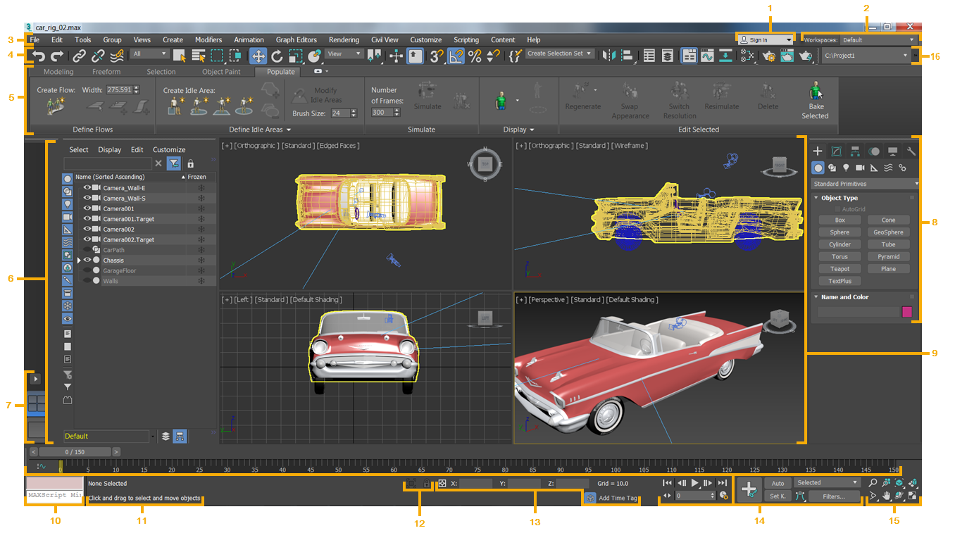

The 3ds Max interface comprises controls, status information, and viewports, where you work and view your scene.

  1. User Account menu
  2. Workspace selector
  3. Menu bar
  4. Main toolbar
  5. Ribbon
  6. Scene Explorer
  7. Viewport Layouts
  8. Command panel
  9. Viewports
  10. MAXScript Mini Listener
  11. Status line and Prompt line
  12. Isolate Selection toggle and Selection Lock toggle
  13. Coordinate display
  14. Animation and Time controls
  15. Viewport Navigation controls
  16. Projects toolbar
