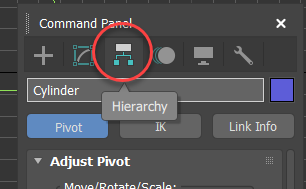

Hierarchy Panel
Found in the Command Panel, the Hierarchy panel provides access to tools to adjust the hierarchical linkage between objects.
The Hierarchy panel

The Hierarchy panel is divided into three areas:
Pivot
IK
Link Info
