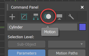

Motion Panel
Found in the Command Panel, the Motion panel provides tools to adjust the motion of the selected object.
The Motion panel
Key timing and easing in and out of a key are parameters that you can adjust with tools on the Motion panel, for example. The Motion panel also provides an alternative to Track View for assigning animation controllers.
Additional rollouts display in the Motion panel depending on what parameters an animation controller. For example, if a Path constraint is assigned to the position track of an object, then a Path Parameters rollout is added to the Motion panel. A Link constraint displays a Link Parameters rollout, a Position XYZ controller displays a Position XYZ Parameters rollout, and so on.
