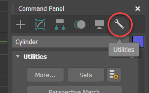

Utilities Panel
Found in the Command Panel, the Utilities panel gives you access to a variety of useful tools.
The Utilities panel

The Utilities panel contains one rollout for managing and invoking utilities. While a utility is running, additional rollouts can appear. Some utilities use a dialog rather than rollouts.
The Utilities rollout contains the following controls at the top:
More
Displays a Utilities dialog that lists all utilities not already displayed in buttons on the Utilities panel. Highlight a utility in the list and then click OK to display its controls in the Utilities panel. (You can also double-click the utility's name.)
