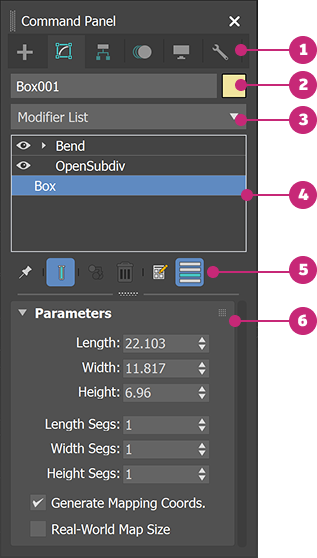

The Modify panel provides controls for editing object parameters as well as applying modifiers to objects and adjusting modifier settings. It also contains the modifier stack, a powerful tool for viewing and changing an object's edit history.
Modify panel (example)
1. Command panel tabs
2. Name and color fields
3. Modifier list (drop-down)
4. Modifier stack
5. Modifier stack tools
6. Parameters rollout
