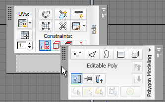

To dock a panel to a floating panel or panel group, drag the first to the others until a “landing zone” (rectangular outline, as shown in the illustration) appears on the target, and then release the mouse button.
Docking one floating panel to another
Thereafter you can move the panel group as a unit.

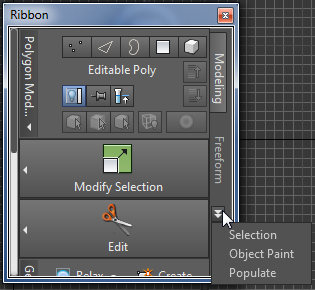

When the ribbon floats and has been reduced in size so that not all tab labels fit, the remaining tabs are available from a drop-down list that opens by clicking a double-arrow button:

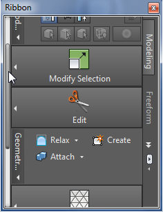

When the ribbon floats, you can resize it both horizontally and vertically by dragging a vertical or horizontal edge, respectively. When you reduce the vertical ribbon height, the panel contents scale as much as possible; thereafter, a scroll bar becomes available for scrolling through the panels.
Vertical ribbon with scroll bar on left side

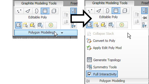

At the bottom or right side of every panel is the title bar; if Show Panel Titles is off, a thin bar takes its place. If the title bar contains a small arrowhead, that means it can be expanded to show additional controls. To expand the panel, click the title.
The panel expansion remains open as long the mouse cursor stays on it. To close it, simply move the mouse away.
Left: Click the panel title bar ...
Right: ... to open the panel expansion.

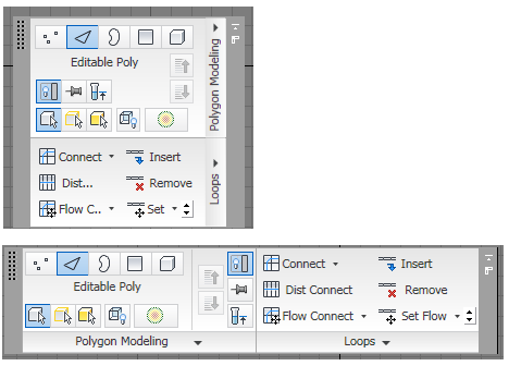

Toggle OrientationSwitches the panel group layout between vertical and horizontal. Available only on floating panels.
Top: Floating panel group in vertical orientation
Bottom: Floating panel group in horizontal orientation
