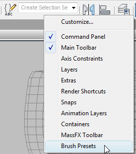

  2. Right-click an empty area on a toolbar, such as the main toolbar below the Named Selection Sets drop-down list, and choose Brush Presets.
    This opens the Brush Presets toolbar.
