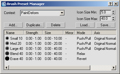

Brush Preset Manager
The Brush Preset Manager lists all brush presets, showing the context-specific settings and lets you change contexts. It also lets you rename, add, copy, and delete presets, and set the range for the depiction of brush sizes on the toolbar. Lastly, it lets you save and load custom collections of brush presets using the BPR file format.

  3. image On the toolbar, click Brush Preset Manager.
Interface
Context
Choose the context for the settings in the list window. The Brush Presets feature recognizes four contexts and shows the current context as active:
Icon Size Min/Max
Sets the range of the brush size depicted on the toolbar. Changing the actual brush size between the minimum and maximum settings changes the image of the brush as depicted on its button to show its size relative to the other presets. Changes to the brush size outside these limits are not reflected on the toolbar buttons.
Add
Adds a new preset to the list, using the current brush settings. When you click Add, you're prompted to enter a name for the new preset. Edit the name and then click OK to create the new preset. The new preset appears highlighted at the end of the list and the toolbar.
Note: If 50 presets already exist, you won't be able to add any new ones.
Duplicate
Adds a copy of the highlighted preset to the list. When you click Duplicate, you're prompted to enter a name for the new preset. Edit the name and then click OK to create the new, duplicate preset. The preset appears highlighted at the end of the list and the toolbar.
Note: If 50 presets already exist, you won't be able to add any new ones via duplication.
Delete
Deletes the brush preset highlighted in the list from both the list and the toolbar.
Load
Lets you load a saved Preset (BPR) file. Click Load to open the Load Brush Preset File dialog, click a BPR file to load, and then click Open. The loaded Preset file replaces the current presets.
Save
Lets you save a custom Preset (BPR) file, containing all current brush presets. Click Save to open the Save Brush Preset File dialog, specify a BPR file to save, and then click Save. You can then load the Preset file into 3ds Max at any time.
[presets list]
Shows all presets in a scrollable list. Each list entry shows a small version of the button image, the preset name, ranges for Strength and Size, Mirror and Mode settings, and other settings depending on the context.
To rename a button preset, double-click its name and then edit or enter a new one. Other settings are available from the applicable rollout and the Painter Options dialog. For example, you can set the brush strength and size on the applicable rollout, but to set the range, which is used by a pressure-sensitive input device such as a pen and tablet, you must use the Painter Options dialog. Mirror options are also available only from this dialog.
The list shows the following general and contextual information:
