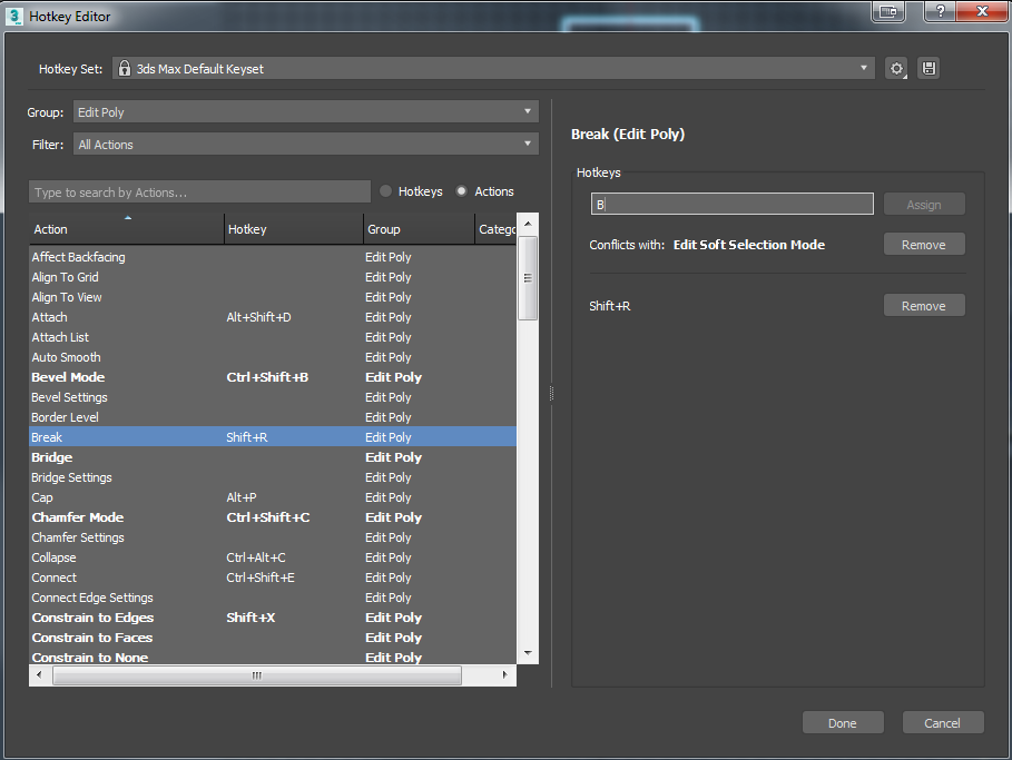

Hotkey Editor
Use the Hotkey editor to find existing hotkeys, make changes to your hotkeys, and create custom hotkey presets.
Keyboard shortcuts can be filtered in the editor by component group, and searched for by either action name or a specific hotkey. Any changes are unsaved until the Done button is clicked at the bottom of the window.
Interface
Hotkey Set
Selects a hotkey set to load. You can choose the 3ds Max Default keyset, the Maya Default keyset, or a custom preset you have created and saved.

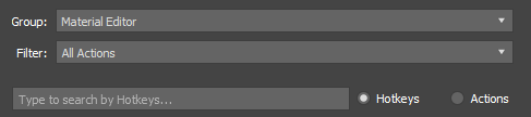

Group
Shows only the actions from a specific component group.
Filter
Filters the list of actions based on their hotkeys. You can choose to view all actions, only actions with already assigned hotkeys, only actions with customized hotkeys, or only those with unsaved hotkeys.
Searches any input text for matches as either actions or hotkeys, depending on the Hotkeys or Actions radio button selected to the right.

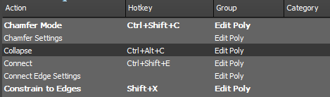

Action List
Action, Hotkey, Group, and Category Columns
Click a column name to reorder the list alphabetically by either action, hotkey, group, or category. Click the column name again to arrange the list in descending order.
Note: Actions shown in boldface can be used to override current operations. For more information, see the Actions Listed in Boldface section below.

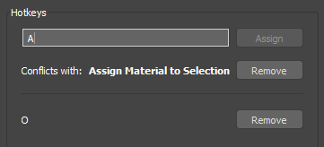

Hotkeys panel
Press Keys
Sets the hotkey or hotkey combination to assign. Click in the field and press the desired key on your keyboard. If there are no conflicts shown below, click Assign to complete the action. If a conflict is shown, you must first click Remove in order to make the key available.
Note: You cannot assign more than six hotkeys per action.

Done
Exits the editor. If there are unsaved changes, a prompt will ask whether or not you want to save them.
Cancel
Cancels editing and exits the editor. If there are unsaved changes, a prompt will ask whether or not you want to save them.
Actions shown in boldface are used to temporarily override the current operation by pressing its assigned hotkey for longer than 0.2 seconds. For example, while editing an Editable Poly object at the Polygon sub-object level, pressing and holding Shift+Ctrl+B will temporarily activate the Bevel tool. As soon as you release the hotkey, the current operation is restored.

  4. Click in the Press keys field, then press the keyboard shortcut or combination that you want to assign to the action.
    Note: If the keyboard shortcut is already assigned to another action in the same group, the conflicting action name appears below the Press keys field.
  5. Click Remove in the case of a conflict, and then click Assign to assign the new hotkey to the action.
