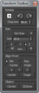

Transform Toolbox
The Transform Toolbox contains functions for easy object rotation, scaling, and positioning as well as for moving object pivots.

Rotate group
Size group
Align Pivot group
Object group
Rotate group
Rotates the current selection (including sub-objects) clockwise and counter-clockwise based on the view direction; clockwise always rotates clockwise in the current view. Align the view roughly to any axis and click an arrow button to rotate the object by the amount specified by the Degrees value. If the Reference Coordinate System is set to Local, you can rotate the object on its local axis by first aligning the view roughly to the object’s local axis. If the coordinate system is set to Screen, the object will be rotated accordingly.

Size group
Sets the size in 3ds Max units for the selected object on a single axis or all axes simultaneously.

Align Pivot group
These tools align the pivot of the selected object. Choose the location to move the pivot to and then click X, Y, or Z.

Object group
Center
Moves the object to the center of the world (origin).
QClone (Quick Clone)
Makes a copy of the selected object and moves it to the side by the same amount as the object’s width. Align the view roughly to any axis and apply.
