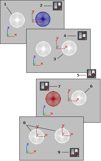

For example, you might select a single object and choose Use Transform Coordinate Center, and then select multiple objects and choose Use Pivot Point Center. When you next select a single object, 3ds Max switches back to Use Transform Coordinate Center. Then, when you select multiple objects, the center switches back to Pivot Point.
1. User selects single object.
2. User clicks Use Transform Coordinate Center from Use Center flyout on the main toolbar.
3. User adds second object to selection.
4. Transform center changes to Use Selection Center when selection set contains more than one object.
5. User clicks Use Pivot Point Center while multiple objects still selected.
6. User selects single object.
7. Transform center returns to Use Transform Coordinate Center (see step 2).
8. User selects multiple objects.
9. Transform center returns to Use Pivot Point Center (see step 5).
