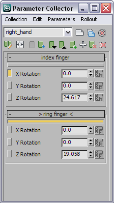

Parameter Collector takes the form of a dialog with a menu bar, a toolbar, and rollouts that you create and modify using the dialog tools. You can resize the dialog horizontally and vertically; expanding it lets you see all rollouts simultaneously.
The menu bar provides a range of functions for using Parameter Collector. See Parameter Collector Menu Bar for details. Also, you can open the Spinner Right-Click menu by right-clicking a numeric field in Parameter Collector.

Rollouts
Rollouts work the same way in Parameter Collector as they do on the command panel. You can expand and collapse a rollout by clicking its title bar, and move it to another location by dragging the title bar. You can resize the dialog to be able to see all rollouts at once.
Only one rollout can be selected at a time. You select a rollout by clicking the horizontal bar beneath the title; when selected, this bar is orange-yellow in color, and angle brackets surround the rollout title (for example, “> Hand Parameters <”).
The interface for each parameter on a rollout is as follows:
[Select Parameter]
A small check button on the left side of the rollout. Click it to toggle the parameter's selection status. When selected, the button appears pressed in and is colored yellow-orange.
[parameter name]
By default, the parameter has the same name as is shown in Track View, but you can change it with the Edit menu > Edit Notes command. You can see the default name for a parameter as well as the object it controls, if any, by hovering the mouse over the parameter name; the information appears on a tooltip.
[parameter value]
Shows the current value of the parameter. The parameter type determines how this appears: numeric field/spinner, color swatch, etc. You can edit the value the same way as on the command panel or a dialog.
If a key exists for the value at the current frame, the spinner or swatch appears with red brackets at the corners.
image [Properties]
Opens a Key Info dialog for the parameter. Available only if the parameter has an animation controller.
Use the Key Info dialog to edit an animation key's value, time, and interpolation methods.
