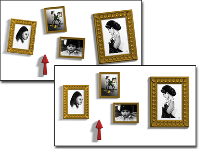

Aligning Multiple Objects
Aligning multiple objects to the arrow object (each photo is adjusted in a different correction)
When you select multiple objects for alignment, the same settings apply to all of them. However, the effect on each source object can be different. In practice, you're aligning separate objects at the same time with the same settings.
To align a collection of objects as a single unit, select the objects and group them. The alignment now takes place relative to the pivot and bounding box of the entire group.
