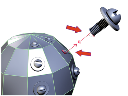

3ds Max lets you align the normals between any two objects. In the case of mesh objects, the alignment is between individual faces, because each face has its own normal. See Normal Align.
Normal on the front of the bolt is aligned with the normal of a face on the assembly.
Basics of Aligning Normals
Before you begin, select a view that lets you see both objects you want to align. If necessary, you can navigate the view after selecting the first normal. To see face normals clearly, work in a wireframe viewport.
For details on the procedure and dialog settings, see Normal Align.
