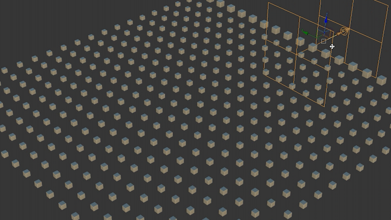

The above effect was created using the following sample script, which scales the selected objects based on the Float value of a Field Helper named Field001.
fh = $Field001
for node in $selection do (
    ph = Point pos:node.pos
    hide ph
    cc = Float_Field_Probe_Control fieldNode:fh probeNode:ph
    node.scale.controller = ScaleXYZ()
    node.scale.controller.X_Scale.controller = cc
    node.scale.controller.Y_Scale.controller = cc
    node.scale.controller.Z_Scale.controller = cc

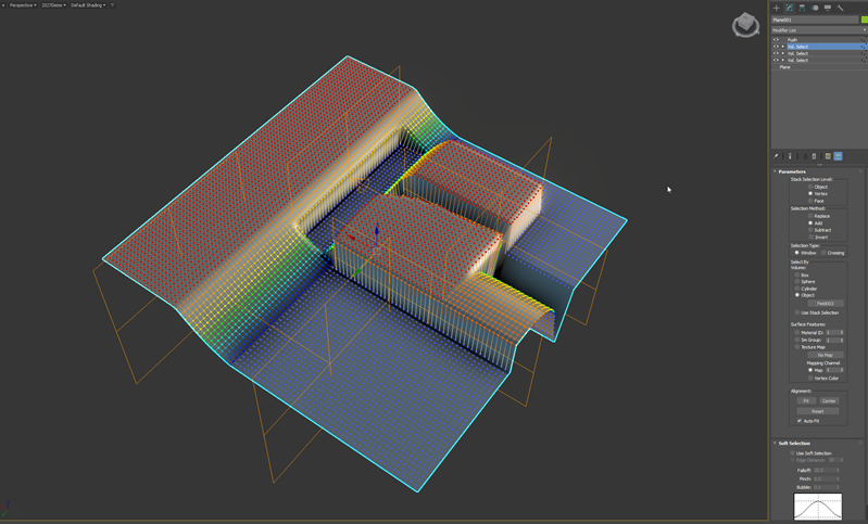

Using Field Helper with Volume Select
The Volume Select modifier supports Field Helper objects as effectors.
To use:
  1. Add a Volume Select modifier to an object.
  2. Assign the Field Helper as the selection object.
  3. Adjust the Field Helper 's Size, Falloff, and Interpolation to control selection behavior.
Field values determine the selection weighting.
Note: When using Volume Select with a Field Helper, traditional soft selection is not supported. Use the Field Helper 's Falloff parameter to control transition strength, which behaves similarly to soft selection, allowing for smooth transitions at the boundary of the field.
