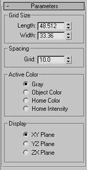

In the Parameters rollout of each grid object is a Display group with three options: XY Plane, YZ Plane, and ZX Plane. These determine which of the three planes of the grid object is displayed in the viewport.

If you want to change the actual size of the grid object, select it and go to the Modify panel > Parameters rollout > Grid Size group, and change the Length and Width settings.

Sets the overall size of the grid object. This size determines the extents of a viewport set to the grid object. It doesn't affect the useful limits of the grid, which extend infinitely.
Specifies the length and width of the grid.
Specifies the size of the smallest square in the visible grid. This setting appears on the status line when the grid is activated.
Determines the color used to draw the grid in viewports when it's not selected.
Determines which of the three planes of the grid object are displayed in the viewport.
