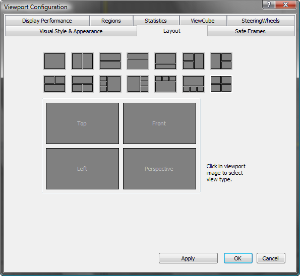

3ds Max defaults to a 2 x 2 arrangement of viewports. Thirteen other layouts are available, but the maximum number of viewports on the screen remains four.
Using the Layout Panel of the Viewport Configuration dialog, you can pick from the different layouts and customize the viewports in each. The viewport configuration is saved with your work.
After choosing a layout you can resize the viewports so they have different proportions by moving the splitter bars that separate the viewports. This is available only when multiple viewports are displayed.
Resized viewport
