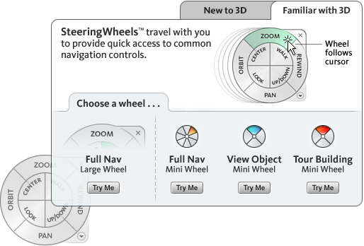

SteeringWheels
The SteeringWheels ® 3D navigation controls are tracking menus that allow you to access different 2D and 3D navigation tools from a single tool.
SteeringWheels are divided into different sections known as wedges. Each wedge on a wheel represents a single navigation tool. You can pan, zoom, or manipulate the current view of a scene in different ways.
SteeringWheels, also known as wheels, can save you time by combining many of the common navigation tools into a single interface. Wheels are specific to the context that a scene is being viewed in.
The Full Navigation wheel
First Contact Balloon
By default, the wheel is inactive at startup. However, if you enable the Always Show the Pinned Wheel on Start option, the wheel is “pinned” at startup to the lower-left corner of the Perspective viewport. It does not follow the cursor and, when you position the cursor over the wheel, the First Contact balloon for the SteeringWheels opens. The First Contact balloon serves as an introduction to the purpose of the wheels and how you can use them.
Display and Use Wheels
To toggle display of a wheel, use the Views menu > SteeringWheels > Toggle SteeringWheels command or the keyboard shortcut ( Shift+W, by default). When a wheel is displayed, you can activate its navigation tools either by clicking one of the wedges on the wheel or clicking and holding down the button on the pointing device. While the button is held down, dragging over the viewport causes the current view to change. Releasing the button returns you to the wheel, and right-clicking at any time closes the wheel.

You can control the appearance of the wheels by changing the current mode, or by adjusting the size and opacity. Wheels are available in two different modes: big and mini. To use a different wheel, choose it from the Wheel menu on a full-size wheel (click the lower-right button on the wheel) or from the Views menu > SteeringWheels submenu.
In addition to changing the current mode, you can adjust the opacity and size for the wheels. The size of a wheel controls how large or small the wedges and labels appear on the wheel; the opacity level controls the visibility of the objects in the viewport behind the wheel. The settings used to control the appearance of the wheels are on the SteeringWheels panel of the Viewport Configuration dialog.
