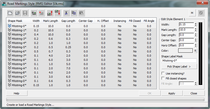

The Road Markings Style Editor lets you apply of a range of road-marking types to a visualization model by associating a road-marking type with a series of shape label masks.

[road marking style element list]
Lists the contents of the current road marking style. Each line shows an individual element. Click to highlight an element and see its details in the element editor to the right.

[list of elements]
Lists each element in the road marking style, along with its style settings.
Edit Style Element group
The controls in the group to the right let you edit the settings of the highlighted road marking style element.
[preview]
At the right of the editor, a graphic preview shows the results of your edits.
