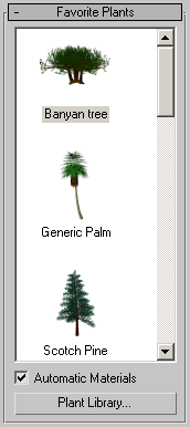

Favorite Plants rollout
The palette displays the plants currently loaded from the Plant Library. There are three ways to add a plant to the scene:
Automatic Materials
Assigns a default Multi Sub-Object material to the plant.
To modify the default material, you can use the Material Editor > image (Pick Material from Object) tool. See Pick Material from Object (Slate) or Pick Material From Object (Eyedropper) (Compact). Once you have picked the material, you can use the Material Editor to reassign sub-materials, change their settings, and so on.
If you turn off Automatic Materials, 3ds Max assigns no material to the object.
Note: Even if Automatic Materials is off, 3ds Max still assigns material IDs to the foliage sub-objects, so that the object is ready for a Multi/Sub-Object material.
Plant Library
Displays the Configure Palette dialog. Using this window, you can view information on the available plants including their names, whether they’re in the palette, their scientific names, types, descriptions, and the approximate number of faces per object. You can also add and remove plants from the palette, and clear the palette, which removes all plants from the palette.
Tip: To quickly add or remove a plant from the palette, double-click its row in the Configure Palette dialog. The Fav. (Favorite Plants) column entry switches between "no" and "yes." Click OK to accept the changes and exit the window.

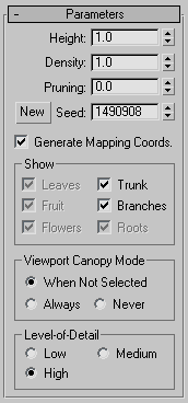

Parameters rollout
Height
Controls the approximate height of the plant. 3ds Max applies a random noise factor to the height of all of the plants. Therefore, the actual height of a plant, as measured in the viewports, won't necessarily match the setting given in the Height parameter.
Density
Controls the amount of leaves and flowers on the plant. A value of 1 displays a plant with all its leaves and flowers, .5 displays a plant with half its leaves and flowers, and 0 displays a plant with no leaves or flowers.
Two trees with varying foliage densities
Pruning
Applies only to plants with branches. Removes branches that lie below an invisible plane parallel to the construction plane. A value of 0 prunes nothing, a value of 0.5 prunes the plant at a plane halfway up its height from the construction plane, and a value of 1 prunes everything possible from the plant. What 3ds Max prunes from the plant depends on the type of plant. The trunk is never pruned.
Three pairs of trees, showing different values of pruning
New
Displays a random variation of the current plant. 3ds Max displays the seed value in the numeric field next to the button.
Tip: Click the New button repeatedly until you find the variation you want. This is often easier than trying to adjust the tree using modifiers.
Seed
A value between 0 and 16,777,215 representing the possible variations of branch and leaf placement and shape and angle of the trunk of the current plant.
Generate Mapping Coords
Applies default mapping coordinates to the plant. Default=on.
Show group
Controls the display of leaves, fruit, flowers, trunk, branches, and roots of plants. Available options depend on the type of plant you select. For example, if a plant doesn’t have fruit, 3ds Max disables that option. Turning off options reduces the number of vertices and faces displayed.
Viewport Canopy Mode group
In 3ds Max, the canopy of a plant is a shell covering the outermost parts of the plant, such as the leaves or the tips of the branches and trunk. The term derives from "forest canopy." Use reasonable parameters when you create many plants and want to optimize display performance.
Because this setting applies only to the plant's representation in the viewports, it has no effect on how 3ds Max renders the plant. For information on how 3ds Max renders the plant, see Level-of-Detail.
Level-of-Detail group
Controls how 3ds Max renders the plant. For information on how 3ds Max displays the plant in the viewports, see Viewport Canopy Mode.
Tip: Set the parameters before creating multiple plants. This can avoid slowing down the display, and might reduce editing you have to do on the plants.
