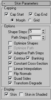

Skin Parameters Rollout
On the Skin Parameters rollout, you adjust the complexity of the mesh of the loft object. You can also optimize the mesh by controlling the face count.

Capping group
Cap Start
When on, the end of a loft at the first vertex of the path is covered, or capped. When off, the end is open, or uncapped. Default=on.
Cap End
When on, the end of a loft at the last vertex of the path is covered, or capped. When off, the end is open, or uncapped. Default=on.

Options group
Shape Steps
Sets the number of steps between each vertex of the cross-section shapes. This value affects the number of sides around the perimeter of the loft.
Left: Shape Steps=0
Right: Shape Steps=4
Path Steps
Sets the number of steps between each main division of the path. This value affects the number of segments along the length of the loft.
Frame lofted with Path Steps=1
Frame lofted with Path Steps=5
Optimize Shapes
When on, the Shape Steps setting is ignored for straight segments of cross-section shapes. If multiple shapes are on the path, only straight segments that have a match on all shapes are optimized. Default=off.
Left: Optimize Shapes turned on
Right: Optimize Shapes turned off
Optimize Path
When on, the Path Steps setting is ignored for straight segments of the path. Curved sections respect the Path steps setting. Available only with Path Steps mode. Default=off.
When Optimize Path is off, the lofted roadway uses more steps.
When Optimize Path is on, straight sections of the lofted roadway don't require additional steps.
Adaptive Path Steps
When on, analyzes the loft and adapts the number of path divisions to generate the best skin. Main divisions along the path occur at path vertices, shape locations, and deformation curve vertices. When off, main divisions along the path occur only at path vertices. Default=on.
Contour
When on, each shape follows the curvature of the path. The positive Z axis of each shape is aligned with the tangent to the path at the shape's level. When off, shapes remain parallel and have the same orientation as a shape placed at level 0. Default=on.
Lofting the roadway with Contour off causes it to twist.
Roadway lofted with Contour turned on
Banking
When on, shapes rotate about the path whenever the path bends and changes height in the path's local Z axis. The bank amount is controlled by 3ds Max. Banking is ignored if the path is 2D. When off, shapes do not rotate about their Z axis as they traverse a 3D path. Default=on.
Roadway lofted with Banking turned on
Constant Cross-Section
When on, the cross sections are scaled at angles in the path to maintain uniform path width. When off, the cross sections maintain their original local dimensions, causing pinching at path angles.
Frame lofted with Constant Cross-Section turned off
Frame lofted with Constant Cross-Section turned on
Linear Interpolation
When on, generates a loft skin with straight edges between each shape. When off, generates a loft skin with smooth curves between each shape. Default=off.
Left: Object lofted with Linear Interpolation turned off
Right: Object lofted with Linear Interpolation turned on
Flip Normals
When on, reverses the normals 180 degrees. Use this option to correct objects that are inside-out. Default=off.
Quad sides
When on, and when two sections of a loft object have the same number of sides, the faces that stitch the sections together are displayed as quads. Sides between sections with different numbers of sides are not affected, and are still connected with triangles. Default=off.
Transform Degrade
Causes the loft skin to disappear during sub-object shape/path transformations. For example, moving a vertex on the path causes the loft to disappear. When off, you can see the skin during these Sub-Object transformations. Default=off.
Display group
Skin
When on, displays a loft's skin in all views using any shading level and ignores the Skin In Shaded setting. When off, displays only the loft sub-objects. Default=on.
Skin in Shaded
When on, displays a loft's skin in shaded views regardless of the Skin setting. When off, skin display is controlled by the Skin setting. Default=on.
The loft object now retains the Skin and Skin In Shaded settings from one loft object to the next one created.
