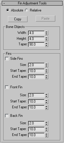

Use controls on the Fin Adjustment Tools rollout for adjusting some aspects of bone geometry, including fins.
Interface
Absolute/Relative
Choose how the numeric settings relate to one another:
Copy
Copies the selected bone's settings; these can then be pasted to another bone.
Paste
Pastes the copied bone and fin settings to the selected bone.
Width/Height
The bone's respective sizes.
Taper
Setting Taper to 0 produces a box-shaped bone. Higher values pinch the bone where it joins its child bone, while lower values expand that end of the bone.
Fins
Use the checkboxes to toggle fins on the respective sides of the bones, and the numeric settings to control the fins' size and taper settings.
