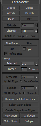

  1. To use Weld:
    1. On the Selection rollout, turn on Ignore Backfacing, if necessary. This ensures that you're welding only vertices you can see.
    2. Select the vertices to weld.
    3. If the vertices are very close together, go to the Edit Geometry rollout > Weld group and click Selected. If that doesn't work (you get a No vertices within weld threshold. message), proceed to the next step.
    4. Increase the numeric value to the right of the Selected button.
      This is the threshold value; the minimum distance that vertices can be apart from each other to be welded.
    5. Click Selected again.
      At this point, one of three things happens: None, some, or all of the vertices are welded. If the latter, you're done. If either of the others occurs, proceed to the next step.
    6. Continue increasing the threshold value and clicking Selected until all of the vertices are welded.
  2. To use Target Weld:
    2. Find two vertices you want to weld, and determine the ultimate location of the resulting vertex. You can weld any two vertices, but for best results the two should be contiguous; that is, they should be connected by a single edge.
      For this example, we'll call the vertices A and B, and the resulting vertex will be at vertex B's location.
    3. Click the Target button.
      The button stays highlighted, to indicate that you're now in Target Weld mode.
    4. Drag vertex A to Vertex B.
      While you're dragging, the mouse cursor image is a four-headed, +-shaped arrow. When over an eligible target vertex, the cursor changes to a crosshairs.
      Tip: If you have trouble dragging in the proper direction, open the Axis Constraints toolbar and click the XY button.
    5. Release the mouse button.
      The pair is welded. The resulting vertex remains at vertex B's position, and you exit Target Weld mode.
      Tip: If you have trouble combining the two vertices, try increasing the Pixels value with the spinner to the right of the Target button.
      You remain in Target Weld mode, and can continue to weld pairs of vertices.
    6. Exit Target mode by right-clicking in the active viewport or clicking the Target button again.
See Edit Geometry Rollout (Mesh) for detailed descriptions of these controls.
