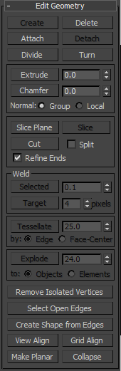

  2. On the Edit Geometry rollout, click Create Shape From Edges.
  3. Make changes, as needed, on the Create Shape dialog that appears.
See Edit Geometry Rollout (Mesh) for detailed descriptions of these controls.
