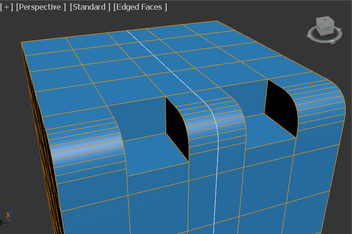

As of 3ds Max update 2022.3, you can use Smart Extrude to cut across multiple edge bodies on the same mesh. See below for two demonstrations of this.
