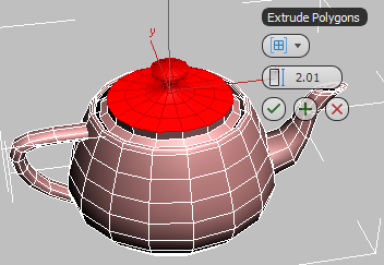

The caddy label appears at the top in white text on a dark background, and displays the feature name (for example, Extrude Polygons) when the mouse cursor isn’t over any control. When the mouse cursor is over a control, the label also displays the control name.
Left: The mouse cursor is not over a control, so the caddy label shows only the feature name.
Right: The mouse cursor is over the Height control.
The caddy first appears near the sub-object selection and remains in that position while open.
To reposition the caddy, drag it by the title. Thereafter it remains in the new position.
