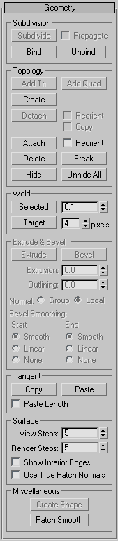

To weld vertices:
  1. At Patch (Vertex) level, select two valid vertices on different patches.
  2. Set Weld Threshold to a value at least equal to the distance between the selected vertices.
  3. Click Selected.
    The two vertices move together and join.

Geometry rollout
See Geometry Rollout (Patch) for detailed descriptions of these controls.
