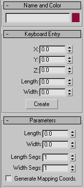

Name and Color rollout
The Name and Color rollout lets you rename objects and change their wireframe color.
Keyboard Entry rollout
X/Y/Z
Sets the patch center.
Length
Sets the patch length.
Width
Sets the patch width.
Create
Creates a patch based on the XYZ, Length, and Width values.
Parameters rollout
Length, Width
Sets the grid dimensions in current units.
Length, Width Segments
Determines the number of facets along the length and width of the grid. Default=1.
The density of a Quad Patch rises sharply as you increase the segments. A Quad Patch of two segments on a side contains 288 faces. The maximum is 100 segments. High segment values can slow performance.
Generate Mapping Coordinates
Creates map coordinates for applying mapped materials. Default=off.
