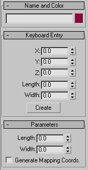

Name and Color rollout
The Name and Color rollout lets you rename objects and change their wireframe color.
Keyboard Entry rollout
X/Y/Z
Sets the patch center.
Length
Sets the patch length.
Width
Sets the patch width.
Create
Creates a patch based on the XYZ, Length, and Width values.
Parameters rollout
Length, Width
Sets dimensions of grid in current units.
Generate Mapping Coordinates
Creates map coordinates for applying mapped materials. Default=off.
