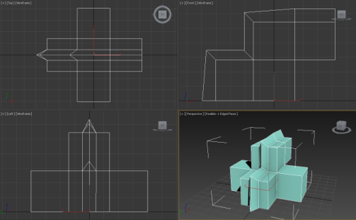

    For best results, the model should have relatively sharp angles (90 degrees or less) that respond well to the smoothing effect. The following illustration shows a qualifying example:
  2. Apply the OpenSubdiv modifier to the model.
    With the default Iterations value of 1, the smoothing is now apparent, as is its low resolution. In assessing the modifier's effect, it also helps to view the mesh subdivision.

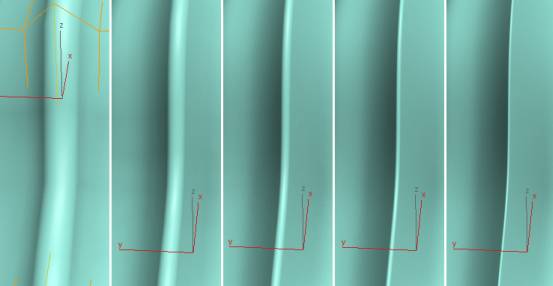

  6. On the modifier stack, access the OpenSubdiv entry, then on the General Controls rollout, click the up arrow on the Iterations spinner once, to change Iterations to 2. Note the difference, then continue clicking slowly until you reach 5. Notice what happens to the crease each time you click.
    In the following illustration, Crease is set to 0.5, and Iterations increases from 1 to 5, from left to right.
    The maximum value permitted with the OpenSubdiv modifier's Iterations setting is 6, which typically supports Crease values of up to 0.5 or so. If you need sharper creasing, you can obtain it as follows:
