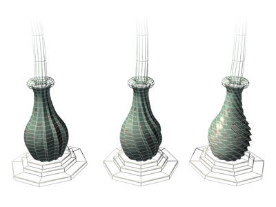

Note: When you apply the Twist modifier, the Twist gizmo's center is placed at the object's pivot point, and the gizmo lines up with the object's local axis.
Left: Original model
Middle: A moderate twist
Right: An extreme twist
