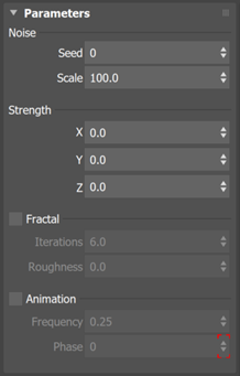

Parameters rollout
Noise group
Controls the appearance of the noise, and thus its effect on the physical deformations of the object. By default, the controls are inactive until you change the settings.
Seed
Generates a random start point from the number you set. Especially useful in creating terrain, because each setting can produce a different configuration.
Scale
Sets the size of the noise effect (not strength). Larger values produce smoother noise, lower values more jagged noise. Default=100.
Strength group
Controls the magnitude of the noise effect. No noise effect occurs until some strength is applied.
X, Y, Z
Set the strength of the noise effect along each of three axes. Enter a value for at least one of these axes to produce a noise effect. Default=0.0,0.0,0.0.
Fractal
Produces a fractal effect based on current settings. Default=off.
If you turn on Fractal, the following options are available:
Iterations
Controls the number of iterations (or octaves) used by the fractal function. Fewer iterations use less fractal energy and generate a smoother effect. An iteration of 1.0 is the same as turning Fractal off. Range=1.0 to 10.0. Default=6.0.
Roughness
Determines the extent of fractal variation. Lower values are less rough than higher values. Range=0 to 1.0. Default=0.
Animation group
Controls the shape of the noise effect by overlaying a sine wave for the noise pattern to follow. This keeps the noise within bounds, dampening random extremes. When Animate Noise is turned on, these parameters influence the overall noise effect. However, you can animate Noise and Strength parameters independently; these do not require Animate Noise to be on during animation or playback.
Animation
Regulates the combined effect of Noise and Strength parameters. The following parameters adjust the underlying wave.
Frequency
Sets the periodicity of the sine wave. Regulates the speed of the noise effect. Higher frequencies make the noise quiver faster. Lower frequencies produce a smoother and more gentle noise.
Phase
Shifts the start and end points of the underlying wave. By default, animation keys are set at either end of the active frame range. You can see the effect of Phase more clearly by editing these positions in Track View. Select Animate Noise to enable animation playback.
